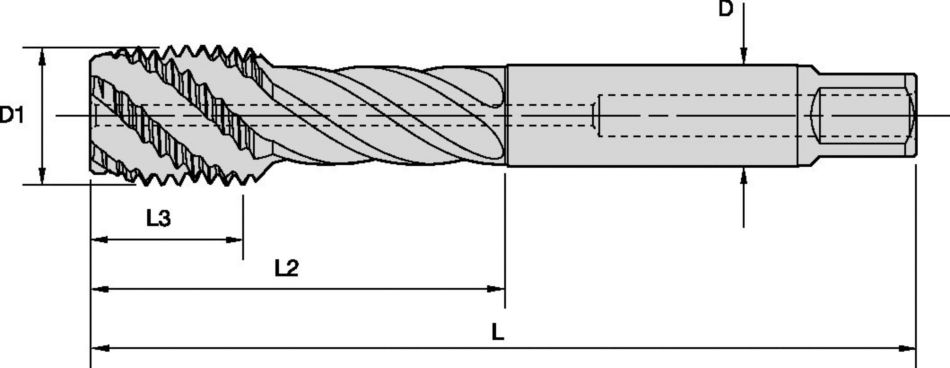

Drawings for 3869008
Material Number3869008
ISO Catalog IDT631MF140X125R6HX-D4
ANSI Catalog IDT631MF140X125R6HX-D4
GradeKP6525
[D1-TDZ] Thread Diameter SizeM14 X 1.25
[L] Overall Length 100 mm
[L] Overall Length 3.94 in
[L3] Thread Length 15 mm
[L3] Thread Length 0.59 in
[L2] Useable Length 47 mm
[L2] Useable Length 1.85 in
[D] Adapter / Shank / Bore Diameter11 mm
[D] Adapter / Shank / Bore Diameter0.4331 in
[Z] Number of Flutes4
Dimension StandardDIN 374
Thread Tolerance Class ISO6HX-I
