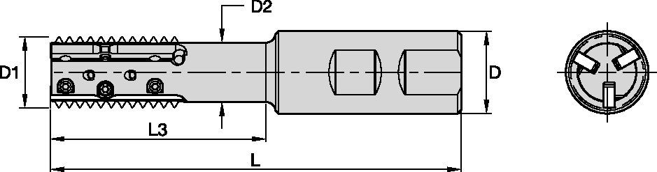

Drawings for 5593185
Material Number5593185
ISO Catalog IDTM40D22L65Z3
ANSI Catalog IDTM40D22L65Z3
[D1] Effective Cutting Diameter22 mm
[D1] Effective Cutting Diameter0.866 in
[D] Adapter / Shank / Bore Diameter25 mm
[D] Adapter / Shank / Bore Diameter0.984 in
[D2] Maximum Body Diameter18 mm
[D2] Maximum Body Diameter0.709 in
[L] Overall Length 124 mm
[L] Overall Length 4.882 in
[L3] Usable Length65 mm
[L3] Usable Length2.559 in
