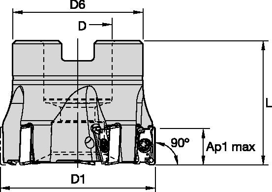

Drawings for 6134233
Material Number6134233
ISO Catalog IDM4D063Z09S22LN11
ANSI Catalog IDM4D063Z09S22LN11
[D1] Effective Cutting Diameter63 mm
[D1] Effective Cutting Diameter2.48 in
[D] Adapter / Shank / Bore Diameter22 mm
[D] Adapter / Shank / Bore Diameter0.866 in
[D6] Hub Diameter 49.98 mm
[D6] Hub Diameter 1.968 in
[L] Overall Length 40 mm
[L] Overall Length 1.575 in
[AP1MAX] 1st Maximum Cutting Depth11 mm
[AP1MAX] 1st Maximum Cutting Depth0.433 in
Number of Inserts9
Weight Kilograms0.56
Max RPM19500
