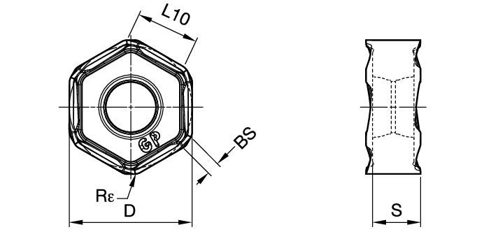

Drawings for 7033334
Metryczne
Calowe
Nr materiału7033334
Nr katalogowy ISOHNGJ0604ANERGP
Nr katalogowy ANSIHNGJ43ANERGP
GradeKTPK20
[D] Insert IC Size12 mm
[D] Insert IC Size0.472 in
[S] Insert Thickness4.72 mm
[S] Insert Thickness0.185 in
[L10] Insert Cutting Edge Length6.928 mm
[L10] Insert Cutting Edge Length0.2728 in
[BS] Corner Facet Length 1.1 mm
[BS] Corner Facet Length 0.044 in
[Rε] Corner Radius 1 mm
[Rε] Corner Radius 0.039 in
Average Chip Thickness [HM]0.06 mm
Average Chip Thickness [HM]0.0024 in
Cutting Edges per Insert12
