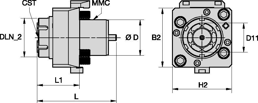

      Sterowane narzędzie osiowe • ER™ • TACU009ER40DA61301844
      Okuma • napędzane oprawki osiowe • ER • MMC 009
      Metryczne
      Calowe
      SAP Material Number 6588964
      ISO Catalog Number TACU009ER40DA61301844
      ANSI Catalog Number TACU009ER40DA61301844
      [CST] Catalog Collet Series ER40
      Machine Mount Code 009
      [B2] Overall Width 100.0000 mm
      [B2] Overall Width 3.937 in
      [D] Adapter / Shank / Bore Diameter 60.0 mm
      [D] Adapter / Shank / Bore Diameter 2.362 in
      [D11] Lock Nut Diameter 49.0000 mm
      [D11] Lock Nut Diameter 1.929 in
      Lock Nut Diameter [DLN_2] 66.0000 mm
      HLD_LOCK_NUT_DIA_2_I 2.598 in
      [H2] Overall Height 100.0000 mm
      [H2] Overall Height 3.937 in
      [L] Overall Length 133.0000 mm
      [L] Overall Length 5.236 in
      [L1] Gage Length 69.0000 mm
      [L1] Gage Length 2.716 in
      Torque Machine Spindle Nm 50.000
      Coolant Pressure Bar 70.0
      Coolant Pressure PSI 1000.0
      Coolant Delivery I/E
      [CS1] Coolant Supply Exit Size M12X1
      Max RPM 6000
      Weight Kilograms 4.65
      Torque Newton Meters 128.000
      Torque Foot Pounds 94.0000
