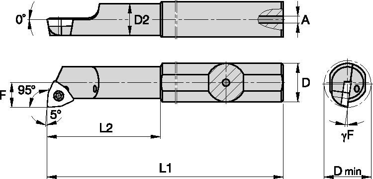

Drawings for 1094703
Material Number1094703
ISO Catalog IDA0306SWLPR15
ANSI Catalog IDA0306SWLPR15
[D] Adapter / Shank / Bore Diameter9.525 mm
[D] Adapter / Shank / Bore Diameter0.375 in
[DM] Minimum Bore Diameter 6.604 mm
[DM] Minimum Bore Diameter 0.26 in
[D2] Head Diameter 6.35 mm
[D2] Head Diameter 0.25 in
[F] F Dimension 3.07 mm
[F] F Dimension 0.1209 in
[L1] Tool Length 88.9 mm
[L1] Tool Length 3.5 in
[L2] Head Length 25.39 mm
[L2] Head Length 1 in
[A] Coolant Hole Diameter 1.981 mm
[A] Coolant Hole Dia 0.078 in
