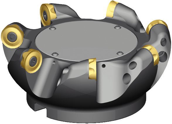

KSRM™ 20 • Shell Mill • Metric
Shell Mills
Material Number3095650
ISO Catalog ID125B06RS90RC20CANSI Catalog ID125B06RS90RC20C
[D1MAX] Maximum Cutting Diameter125 mm
[D1MAX] Maximum Cutting Diameter4.921 in
[D1] Effective Cutting Diameter105.09 mm
[D1] Effective Cutting Diameter4.1374 in
[D] Adapter / Shank / Bore Diameter1.5748 in
[D6] Hub Diameter 90 mm
[D6] Hub Diameter 3.5433 in
[L] Overall Length 63 mm
[L] Overall Length 2.4803 in
[AP1MAX] 1st Maximum Cutting Depth10 mm
[AP1MAX] 1st Maximum Cutting Depth0.3937 in
Number of Inserts6
Maximum Ramping Angle0.63
Weight Kilograms2.96
Max RPM15000
Gage InsertRCGT2006M0___
  • 3D Profiling3D Profiling
  • PocketingPocketing
  • Diameter range from 63–200mm.
  • Engineered for roughing titanium with large depths of cut through positive geometry inserts.
  • Anti-rotation feature allows up to six indexable rotations.
  • High coolant pressure capabilities.
