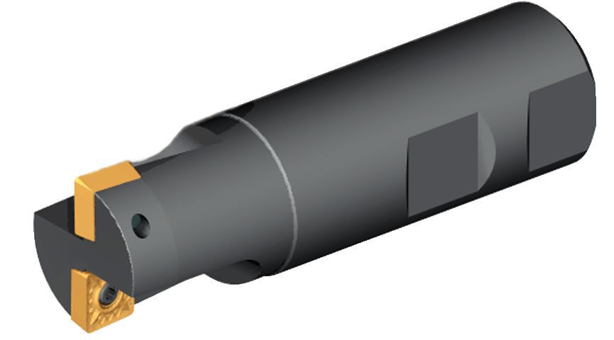

KSSM™ 10 • End Mill • Weldon Shank • Inch
Shoulder milling cutter for multiple materials.
Material Number1229095
ISO Catalog IDKISR125SP10T30FANSI Catalog IDKISR125SP10T30F

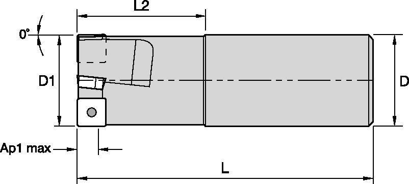

[D1] Effective Cutting Diameter31.75 mm
[D1] Effective Cutting Diameter1.25 in
[D] Adapter / Shank / Bore Diameter31.75 mm
[D] Adapter / Shank / Bore Diameter1.25 in
[L] Overall Length 102.36 mm
[L] Overall Length 4.03 in
[L2] Head Length 44.45 mm
[L2] Head Length 1.75 in
[AP1MAX] 1st Maximum Cutting Depth6.57 mm
[AP1MAX] 1st Maximum Cutting Depth0.259 in
Number of Inserts3
Weight Pounds1.1
Max RPM33200
