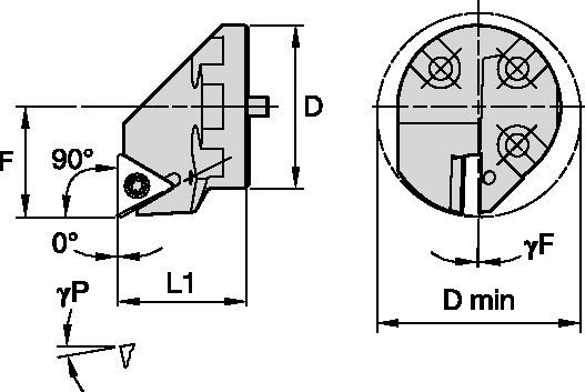

Drawings for 6549404
Material Number6549404
ISO Catalog IDH4050STFCR16
ANSI Catalog IDH4050STFCR16
[D] Adapter / Shank / Bore Diameter1.57 in
[DM] Minimum Bore Diameter 50 mm
[DM] Minimum Bore Diameter 1.9685 in
[F] F Dimension 27 mm
[F] F Dimension 1.063 in
[L1] Tool Length 31.638 mm
[L1] Tool Length 1.2456 in
[GAAP] Axial Rake Angle0
Gage InsertTCMT16T308
