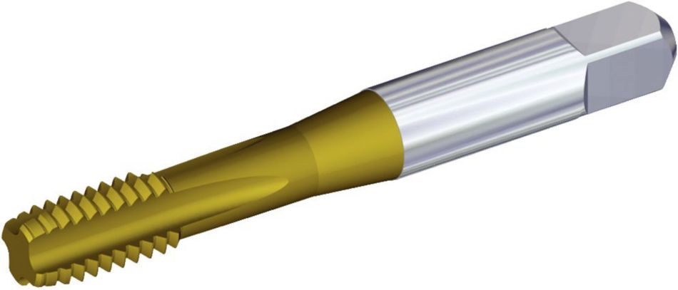

T640 • KP6525 Inch Sizes • ANSI HP HSSE-PM taps for thru and blind holes • Cast & Ductile Iron
Beyond™ Straight-Flute HSS-E-PM Taps • Through and Blind Holes
Material Number4035550
ISO Catalog IDT640NF05000-20R3BX-AANSI Catalog IDT640NF05000-20R3BX-A

Drawings for 4035550
GradeKP6525
[D1-TDZ] Thread Diameter Size1/2 - 20
[L] Overall Length 85.9 mm
[L] Overall Length 3.38 in
[L3] Thread Length 19.6 mm
[L3] Thread Length 0.77 in
[L2] Useable Length 44.2 mm
[L2] Useable Length 1.74 in
[D] Adapter / Shank / Bore Diameter9.322 mm
[D] Adapter / Shank / Bore Diameter0.367 in
[Z] Number of Flutes4
Dimension StandardANSI
Thread Tolerance Class ANSI3BX
  • Tapping: Through HoleTapping: Through Hole
  • Chamfer Form C (2–3)Chamfer Form C (2–3)
  • HSS-E-PMHSS-E-PM
  • Class of Fit: 2BXClass of Fit: 2BX
  • Class of Fit: 3BXClass of Fit: 3BX
  • Manufacturer’s Specs: UNFManufacturer’s Specs: UNF
  • Manufacturer’s Specs: UNCManufacturer’s Specs: UNC
  • Tapping Helix Angle: 0°Tapping Helix Angle: 0°
KP6525
KP6525
Coated HSS-E-PM. PVD — heat- and wear-resistant high vanadium — cobalt powder metal HSS substrate coated with wear-resistant TiCN base layer and low-friction TiN top layer. Use in steel, cast iron, and cast aluminum with silicon.
  • KP6525 TiCN + TiN for cast iron and cast aluminum.
