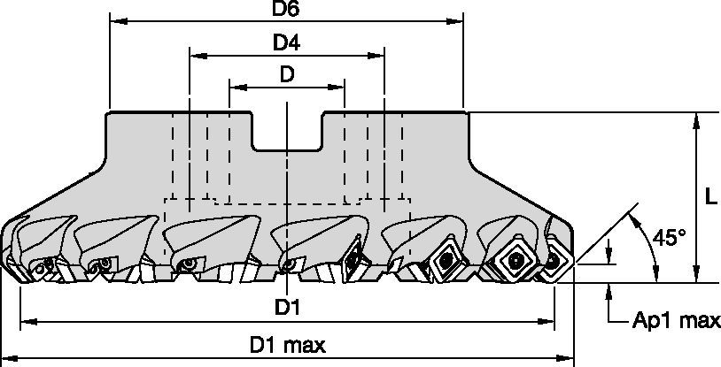

Drawings for 4137781
Material Number4137781
ISO Catalog ID80A06RS45SE14BB
ANSI Catalog ID80A06RS45SE14BB
[D1] Effective Cutting Diameter80 mm
[D1] Effective Cutting Diameter3.15 in
[D1MAX] Maximum Cutting Diameter93.76 mm
[D1MAX] Maximum Cutting Diameter3.691 in
[D] Adapter / Shank / Bore Diameter27 mm
[D] Adapter / Shank / Bore Diameter1.063 in
[D6] Hub Diameter 60 mm
[D6] Hub Diameter 2.362 in
[L] Overall Length 50 mm
[L] Overall Length 1.97 in
[AP1MAX] 1st Maximum Cutting Depth6.6 mm
[AP1MAX] 1st Maximum Cutting Depth0.26 in
Number of Inserts6
Weight Kilograms1.19
Max RPM14500
