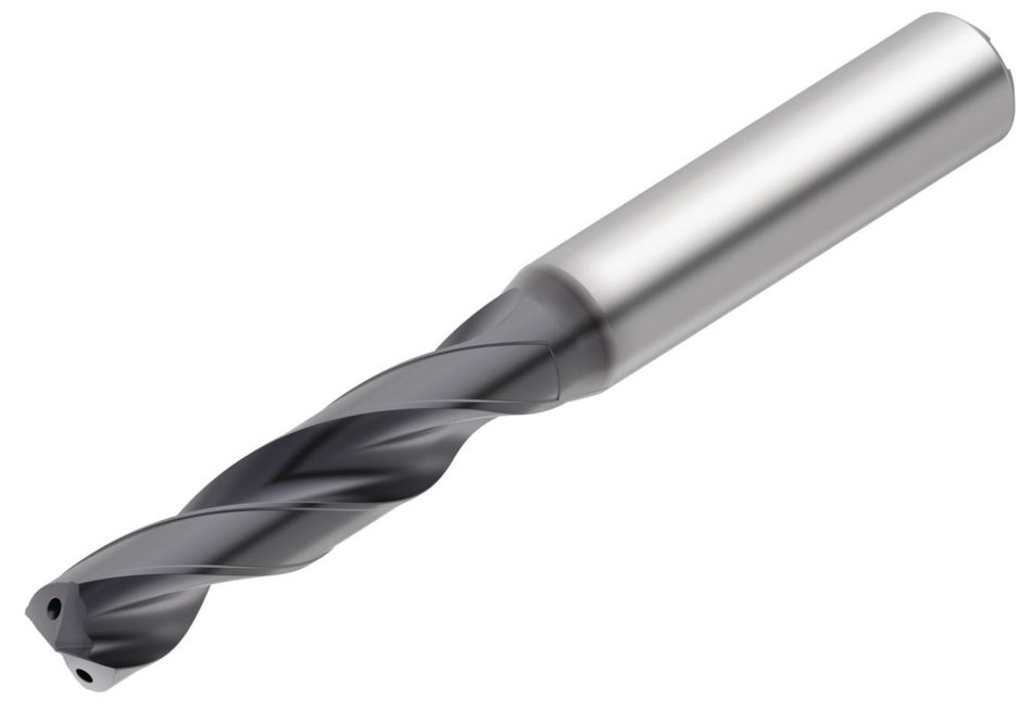

Kenna Universal™ Drill • 3xD • Internal Coolant • Straight Shank • Metric
Solid Carbide Drill for Universal Applications
Material Number1913566
ISO Catalog IDB976A20000ANSI Catalog IDB976A20000

  • DrillingDrilling
  • Tool Dimensions: 2flute/4margin/coolantTool Dimensions: 2flute/4margin/coolant
  • DIN number 6535DIN number 6535
  • DIN number 6537DIN number 6537
  • Through Coolant: MQL (Minimum Quantity Lubricant): DrillingThrough Coolant: MQL (Minimum Quantity Lubricant): Drilling
Drawings for 1913566
GradeKCU15
[D1] Drill Diameter M 20 mm
[D1] Drill Diameter M 0.7874 in
[L] Overall Length 131 mm
[L] Overall Length 5.1575 in
[L3] Flute Length 79 mm
[L3] Flute Length 3.1102 in
[L4] Maximum Drilling Depth 55 mm
[L4] Maximum Drilling Depth 2.1654 in
[L5] Drill Point Length3.48 mm
[L5] Drill Point Length0.137 in
[LS] Shank Length 50 mm
[LS] Shank Length 1.9685 in
[D] Adapter / Shank / Bore Diameter20 mm
[D] Adapter / Shank / Bore Diameter0.7874 in
  • DrillingDrilling
  • Four-margin land design provides hole straightness and roundness, even when drilling cross-holes
  • Low thrust drill point design offers excellent centering and is ideal for unstable machining conditions
  • Easy to recondition, delivering extended tool life
  • Versatile across various machines
  • All shanks meet DIN 6535 and 69090-03 requirements for Minimum Quantity Lubrication (MQL)
