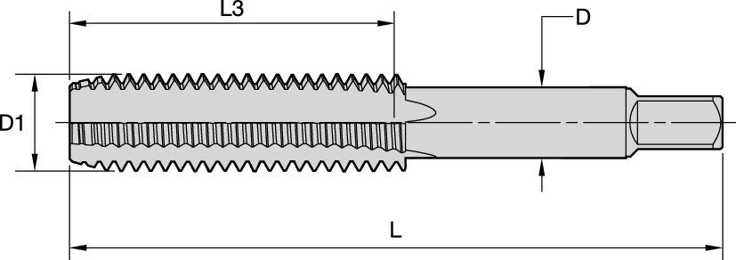

Drawings for 1543746
Material Number1543746
ISO Catalog IDKHSST27730
ANSI Catalog IDKHSST27730
CoatingUncoated
[D1-TDZ] Thread Diameter SizeM4 X 0.7
[L] Overall Length 53.975 mm
[L] Overall Length 2.125 in
[L3] Thread Length 19.05 mm
[L3] Thread Length 0.75 in
[D] Adapter / Shank / Bore Diameter4.267 mm
[D] Adapter / Shank / Bore Diameter0.168 in
[Z] Number of Flutes4
Tap Pitch Diameter LimitD4
Type of ThreadMETRIC
  • Tapping: Through HoleTapping: Through Hole
  • HSSHSS
  • Chamfer Form: 1–2Chamfer Form: 1–2
  • Tapping Helix Angle: 0°Tapping Helix Angle: 0°
