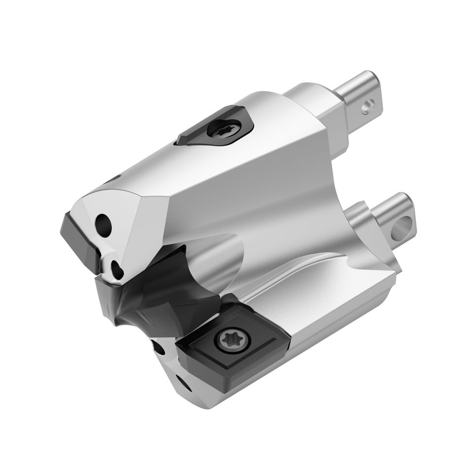

KSEM PLUS™ • B1 Head • Diameter 28.00 - 70.99mm / 1.102 - 2.794″
Modular Drilling • Drill Head with DFC inserts
Material Number5116110
ISO Catalog IDKSEMP4700FDS45B1MANSI Catalog IDKSEMP4700FDS45B1M

- KSEM PLUS™ B1 modular drill head for challenging conditions like stacked plates, cross holes and inclined exits
- Guide pad, insert screws and wrenches are included
- Use two DFC style inserts for this drill head
- Inserts to be ordered separately
