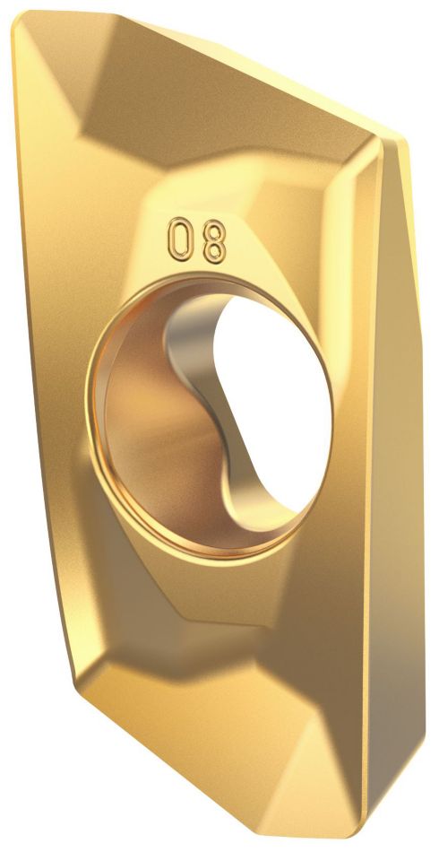

Mill 1-18™ • Carbide Insert • EDPT-GD • Medium Machining
Shoulder milling insert with two cutting edges per insert
Material Number6172393
ISO Catalog IDEDPT180564PDSRGDANSI Catalog IDEP1864S
Mill 1-18 Carbide Insert - EDPT-GD - KCSM40 - EP1864S - 6172393 - Kennametal.com
$26.58/each
Drawings for 6172393
GradeKCSM40
[LI] Insert Length 18.77 mm
[LI] Insert Length 0.739 in
[L10] Insert Cutting Edge Length18 mm
[L10] Insert Cutting Edge Length0.7087 in
[S] Insert Thickness5.5 mm
[S] Insert Thickness0.2165 in
[W] Insert Width 10.64 mm
[W] Insert Width 0.419 in
[Rε] Corner Radius 6.35 mm
[Rε] Corner Radius 0.25 in
Average Chip Thickness [HM]0.127 mm
Average Chip Thickness [HM]0.005 in
Cutting Edges per Insert2
KCSM40
KCSM40
  • Pressed-to-size, for lowest cost per cutting edge.
