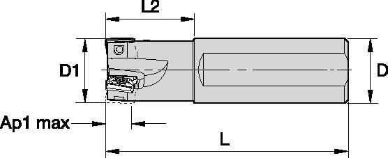

Drawings for 1888462
Material Number1888462
ISO Catalog ID16A02R040A16SAD10
ANSI Catalog ID16A02R040A16SAD10
[D1] Effective Cutting Diameter16 mm
[D1] Effective Cutting Diameter0.6299 in
[D] Adapter / Shank / Bore Diameter16 mm
[D] Adapter / Shank / Bore Diameter0.6299 in
[L] Overall Length 160.21 mm
[L] Overall Length 6.307 in
[L2] Head Length 40.21 mm
[L2] Head Length 1.583 in
[AP1MAX] 1st Maximum Cutting Depth9 mm
[AP1MAX] 1st Maximum Cutting Depth0.354 in
Number of Inserts2
Weight Kilograms0.1
Max RPM16150
  • 90° shoulders.
  • Through coolant.
  • 9mm (0.354") depth-of-cut capability.
