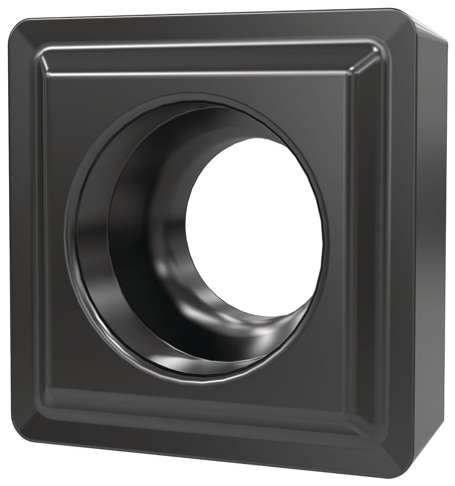

Drawings for 6600792
Material Number6600792
ISO Catalog IDSCMT0602042A
ANSI Catalog IDSCMT21512A
GradeKCK20B
[D] Insert IC Size6.35 mm
[D] Insert IC Size0.25 in
[L10] Insert Cutting Edge Length6.35 mm
[L10] Insert Cutting Edge Length0.25 in
[S] Insert Thickness2.38 mm
[S] Insert Thickness0.0937 in
[Rε] Corner Radius 0.4 mm
[Rε] Corner Radius 0.016 in
[D1] Insert Hole Size 2.8 mm
[D1] Insert Hole Size 0.1102 in
KCK20B
KCK20B
Composition: A multilayered coating with thick MTCVD TiCN-Al2O3-TiOCN layers applied over a carbide substrate specifically engineered for cast irons.
Application: Delivers consistent performance in high-speed machining of grey and ductile irons. The substrate design permits the insert to stay in the cut for a long time at high speeds with minimum deformation. The thick CVD coating and post-coat treatment provide superior wear resistance ensuring long and consistent tool life. Can be applied both in straight and lightly interrupted cuts.
