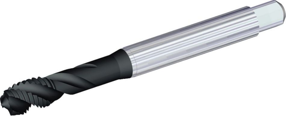

T604 • Metric DIN 371, 374 and 376 • Form C Semi-Bottoming Chamfer
Spiral-Flute HSS-E-PM Taps • Blind Holes (3 x D)
Material Number4161098
ISO Catalog IDT604M030X050R6H-D1ANSI Catalog IDT604M030X050R6H-D1

Drawings for 4161098
GradeKSH26
[D1-TDZ] Thread Diameter SizeM3 X 0.5
[L] Overall Length 56 mm
[L] Overall Length 2.205 in
[L3] Thread Length 6 mm
[L3] Thread Length 0.236 in
[L2] Useable Length 18 mm
[L2] Useable Length 0.7087 in
[D] Adapter / Shank / Bore Diameter3.5 mm
[D] Adapter / Shank / Bore Diameter0.1378 in
[Z] Number of Flutes3
Dimension StandardDIN 371
Thread Tolerance Class ISO6H-I
  • Threading: Blind HoleThreading: Blind Hole
  • Class of Fit: 6HClass of Fit: 6H
  • DIN number 371DIN number 371
  • DIN number 374DIN number 374
  • DIN number 376DIN number 376
  • Chamfer Form C (2–3)Chamfer Form C (2–3)
  • HSS-E-PMHSS-E-PM
  • Manufacturer’s Specs: MFManufacturer’s Specs: MF
  • Tapping Helix Angle: 42°Tapping Helix Angle: 42°
KSH26
KSH26
Coated HSS-E-PM. PVD — powder metal HSS-E substrate coated with TiN base layer and low-friction MoS2 top layer. Use in deep blind steel holes 32–44 HRC.
  • KSH26 TiAlN/MoS2 for tapping steel 32–44 HRC (3 x D).
