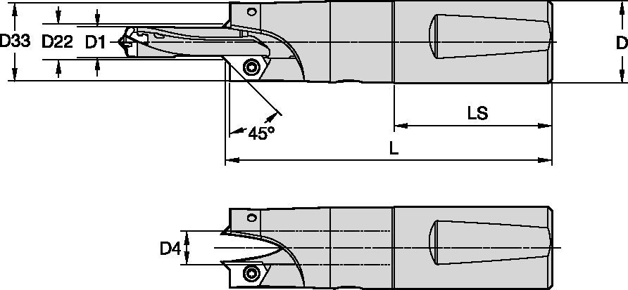

  • Shank - Cylindrical Whistle Notch™Shank - Cylindrical Whistle Notch™
Drawings for 1245719
Material Number1245719
ISO Catalog ID3.37051R820
ANSI Catalog ID3.37051R820
[D33] Cut Diameter 3 15.4 mm
[D33] Cut Diameter 3 0.6063 in
[D22] Cut Diameter 2 9.5 mm
[D22] Cut Diameter 2 0.374 in
[D1] Drill Diameter M 4.1 mm
[D1] Drill Diameter M 0.161 in
[D1MAX] Drill Diameter Maximum4.5 mm
[D1MAX] Drill Diameter Maximum0.177 in
[D4] Mount Bore Diameter 5 mm
[D4] Mount Bore Diameter 0.197 in
[L] Overall Length 87.5 mm
[L] Overall Length 3.4449 in
[LS] Shank Length 50 mm
[LS] Shank Length 1.9685 in
[D] Adapter / Shank / Bore Diameter20 mm
[D] Adapter / Shank / Bore Diameter0.7874 in

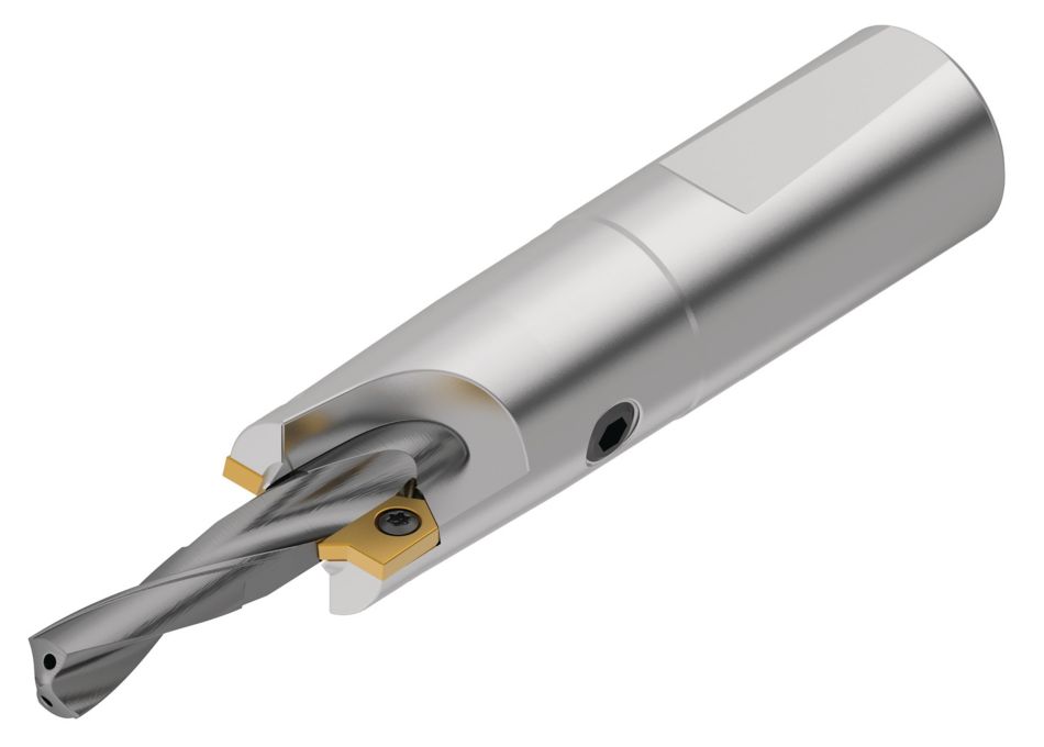

  • For combined drilling and countersinking applications.
  • Applicable for solid carbide drills and KenTIP FS modular drills.
