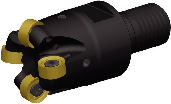

A multilayered TiN-TiCN-Al2O3-CVD-coated carbide grade with advanced Beyond™ post-coat treatment and a very tough substrate. KCMP30 has a wide application area in general and rough milling of steels. It performs best dry but can also be used wet.
  • -GD geometry is for general use in steel and stainless steel.
