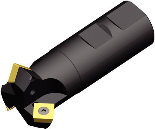

ChamferMill Max 45° • End Mill • Weldon Shank • Metric
End Mills
Material Number1024582
ISO Catalog ID25D2R038B25SSP12ANSI Catalog ID25D2R038B25SSP12
Chamfer Mill - End Mills 45° - SD12 - Metric 1024582 - Kennametal
  • Face MillingFace Milling
  • Shank - Cylindrical Weldon 2 FlatShank - Cylindrical Weldon 2 Flat
Drawings for 1024582
[D1] Effective Cutting Diameter25 mm
[D1] Effective Cutting Diameter0.9843 in
[D1MAX] Maximum Cutting Diameter42 mm
[D1MAX] Maximum Cutting Diameter  in
[D] Adapter / Shank / Bore Diameter25 mm
[D] Adapter / Shank / Bore Diameter0.9843 in
[L] Overall Length 97 mm
[L] Overall Length   in
[L2] Head Length 40 mm
[L2] Head Length   in
[AP1MAX] 1st Maximum Cutting Depth9 mm
[AP1MAX] 1st Maximum Cutting Depth  in
Number of Inserts2
Max RPM16600
Gage InsertSP__1204___
  • 45° countersinking and chamfering cutter.
