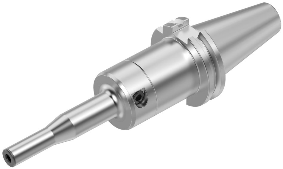

HC Slim T MM-DV Form B/AD
Hydraulic Chucks Slim Line
Material Number3019240
ISO Catalog IDDV50BHCSLT08200MANSI Catalog IDDV50BHCSLT08200M
Hydraulic Chucks Slim Line, XS • DV AD/B
$1,240.91/each
  • Axial Adjustment - SideAxial Adjustment - Side
  • Shank - M24 DrawbarShank - M24 Drawbar
  • Shank - SK DV DIN 69871Shank - SK DV DIN 69871
  • Balance - G 6.3@15,000 min-1Balance - G 6.3@15,000 min-1
  • Accuracy - 6μm or LessAccuracy - 6μm or Less
  • Speed - 20,000 min-1 MaximumSpeed - 20,000 min-1 Maximum
[D1] Adapter / Shank / Bore Diameter8 mm
[D1] Adapter / Shank / Bore Diameter0.315 in
[D2] Body Diameter 1 Workpiece Side 15.5 mm
[D2] Body Diameter 1 Workpiece Side 0.61 in
[L1] Gage Length200 mm
[L1] Gage Length7.874 in
[L2] Usable Length 35 mm
[L2] Usable Length 1.378 in
[L9] Clamping Length 27 mm
[L9] Clamping Hole Length 1.063 in
[V] Adjustment Range 10 mm
[V] Adjustment Range 0.394 in
Actuation Screw ID Drive Size5 mm
Stop Screw ID Drive Size2.5 mm
Weight Kilograms3.81
