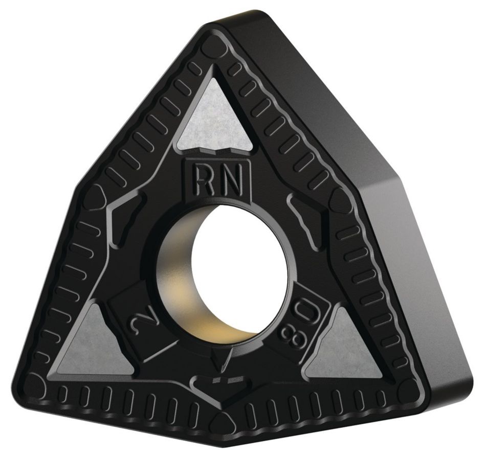

Kenloc™ • WNMG Insert • Negative • RN
ISO Turning Carbide Insert • Roughing Negative Geometry
Material Number3753664
ISO Catalog IDWNMG080408RNANSI Catalog IDWNMG432RN
Kenloc™ WNMG ISO/ANSI Turning Insert 3753664 - Kennametal
GradeKCP30
[D] Insert IC Size12.7 mm
[D] Insert IC Size0.5 in
[L10] Insert Cutting Edge Length8.687 mm
[L10] Insert Cutting Edge Length0.342 in
[S] Insert Thickness4.763 mm
[S] Insert Thickness0.188 in
[Rε] Corner Radius 0.8 mm
[Rε] Corner Radius 0.031 in
[D1] Insert Hole Size 5.156 mm
KCP30
KCP30
Composition: A newly engineered, tough cobalt-enriched carbide grade with an advanced multilayer TiN-MT-TiCN-Al2O3 coating.
Application: For medium to rough machining of all carbon, alloy, and stainless steels. The substrate design provides superior insert strength that is required for this application, and the multilayer coating adds wear resistance to the insert resulting in long tool life.
