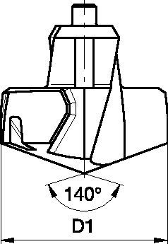

Drawings for 4158912
Material Number4158912
ISO Catalog IDKTIP0940HPM
ANSI Catalog IDKTIP0940HPM
GradeKCP15
[D1] Drill Diameter 9.4 mm
[D1] Drill Diameter 0.3701 in
[L5] Drill Point Length1.62 mm
[L5] Drill Point Length0.0638 in
[SSC] Insert Seat SizeH
