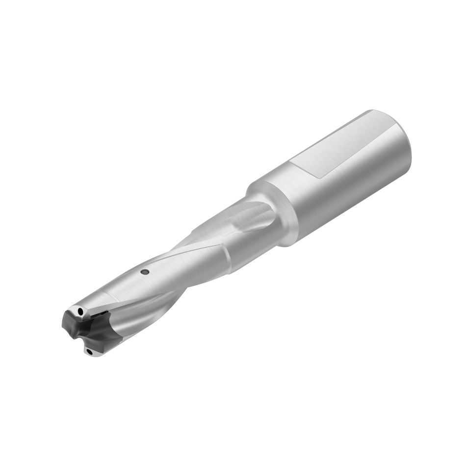

Composition: Multilayered PVD AlCrN-based coated fine-grain carbide.
Application: First choice for cast iron. Due to the uniquely developed coating, this grade exhibits extraordinary wear resistance in abrasive materials offering the highest material removal rates.
  • HPCCL geometry for modular drilling in cast iron.
  • With corner chamfer for wear protection and smooth hole exit.
  • Four margin lands for perfect hole straightness.
