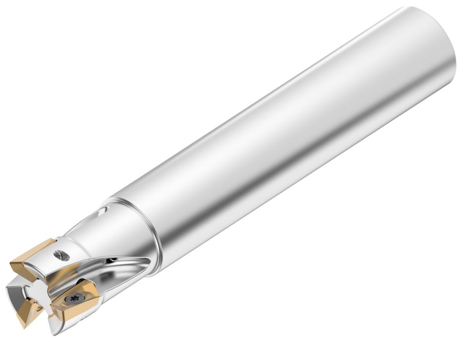

Mill 1-18™ • End Mill • Cylindrical Shank • Metric
Material Number2613787
ISO Catalog ID40A04R050A32SED18-200ANSI Catalog IDM1D040ME1804C032L050-200
- P Steel
- M Stainless Steel
- K Cast Iron
- N Non-Ferrous
- S High-Temp Alloys
- H Hardened Materials
- .caption
Face Milling
Helical Milling
Ramping: Blank
Slotting: Square End
Shank - Cylindrical Plain
Milling - Through Coolant
Pocketing
- Overview
- Application Data
- Downloads
- Spare Parts
| Material Number | 2613787 |
| ISO Catalog ID | 40A04R050A32SED18-200 |
| ANSI Catalog ID | M1D040ME1804C032L050-200 |
| [D1] Effective Cutting Diameter | 40 mm |
| [D1] Effective Cutting Diameter | 1.575 in |
| [D] Adapter / Shank / Bore Diameter | 32 mm |
| [D] Adapter / Shank / Bore Diameter | 1.26 in |
| [L] Overall Length | 200 mm |
| [L] Overall Length | 7.875 in |
| [L2] Head Length | 50 mm |
| [L2] Head Length | 1.97 in |
| [AP1MAX] 1st Maximum Cutting Depth | 17.4 mm |
| [AP1MAX] 1st Maximum Cutting Depth | 0.68 in |
| Number of Inserts | 4 |
| Maximum Ramping Angle | 7.4 |
| Weight Kilograms | 1.18 |
| Max RPM | 28220 |
