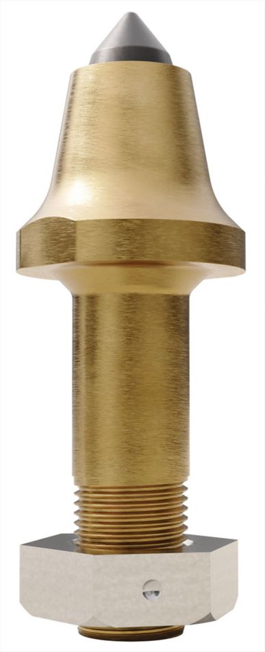

      External Retainer for Maximum Attachment • Cap Tip for Abrasive Conditions
      Метрическая система
      Дюймовая система
      SAP Material Number 1010734
      ISO Catalog Number C 3T
      ANSI Catalog Number C 3T
      Grade K3560
      Point Included Angle [SIGMA] 75.000
      EW_CON_POINT_INCL_ANGLE_B 35.000
      [TD] Tip Diameter 15.875 mm
      [TD] Tip Diameter .6250 in
      [TL] Tip Length 13.462 mm
      [TL] Tip Length .5300 in
      [L1] Gage Length 44.069 mm
      [L1] Gage Length 1.735 in
      [D2] Body Diameter Workpiece Side 38.100 mm
      [D2] Body Diameter Workpiece Side 1.500 in
      [D] Shank/Bore Diameter 19.431 mm
      [D] Shank/Bore Diameter .7650 in
      Connection Thread Size [G3X] 3/4 - 16 UNF
      [LRO] Retainer Offset Length 33.528 mm
      [LRO] Retainer Offset Length 1.320 in
      [LS] Shank Length 58.928 mm
      [LS] Shank Length 2.320 in
      [OAL] Overall Length 103.000 mm
      [OAL] Overall Length 4.060 in
