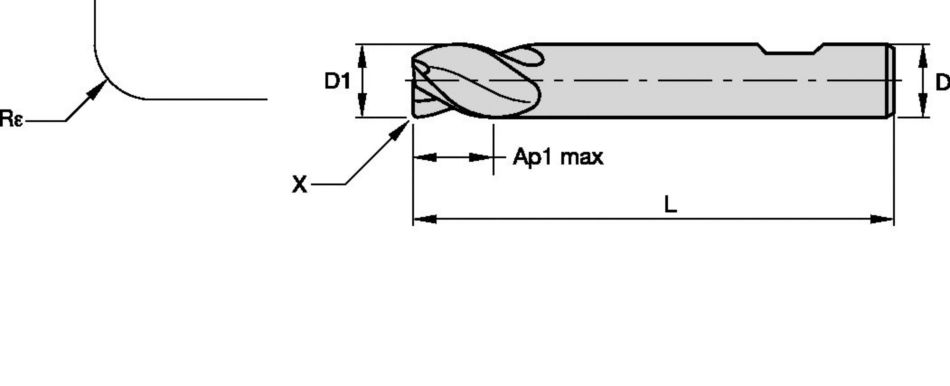

  • Tool Dimensions: Flute Configuration: 4Tool Dimensions: Flute Configuration: 4
Drawings for 4067240
Material Number4067240
ISO Catalog IDHPHV625S4075LR030
ANSI Catalog IDHPHV625S4075LR030
GradeKCPM15
Adapter Style Machine SideWeldon
[Re] Corner Radius 0.75 mm
[Re] Corner Radius 0.03 in
[Z] Number of Flutes4
[D1] Effective Cutting Diameter15.875 mm
[D1] Effective Cutting Diameter0.625 in
[D] Adapter / Shank / Bore Diameter15.875 mm
[D] Adapter / Shank / Bore Diameter0.625 in
[AP1MAX] 1st Maximum Cutting Depth19.05 mm
[AP1MAX] 1st Maximum Cutting Depth0.75 in
[L3] Usable Length19.05 mm
[L3] Usable Length0.75 in
[L] Overall Length 88.9 mm
[L] Overall Length 3.5 in
