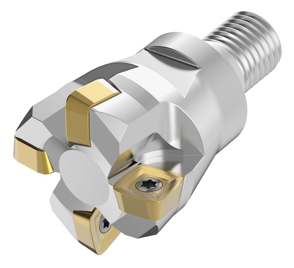

7792VXD12 Series • End Mill • Screw-On • Metric
High-Feed copy milling cutter for multiple materials.
Material Number6025562
ISO Catalog ID7792VXD12SA042Z4R43ANSI Catalog ID7792VXD12SA042Z4R43

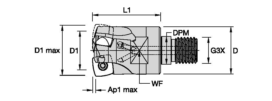

[D1MAX] Maximum Cutting Diameter42 mm
[D1MAX] Maximum Cutting Diameter1.6536 in
[D1] Effective Cutting Diameter23.83 mm
[D1] Effective Cutting Diameter0.938 in
[L2] Head Length 43 mm
[L2] Head Length 1.6929 in
[G3X] Connection Thread Size ExternalM16
[DPM] Pilot Diameter Machine Side17 mm
[DPM] Pilot Diameter Machine Side0.6693 in
[AP1MAX] 1st Maximum Cutting Depth2.5 mm
[AP1MAX] 1st Maximum Cutting Depth0.0984 in
[Z] Number of Flutes4
  • Spiral CircularSpiral Circular
  • Slotting: ShoulderSlotting: Shoulder
  • Face MillingFace Milling
  • PocketingPocketing
  • Counter BoringCounter Boring
  • Plunge Milling: Ball NosePlunge Milling: Ball Nose
  • Inclined Square End MillInclined Square End Mill
  • Internal coolant supply
  • Positive design to support low cutting forces and applications with long overhang
