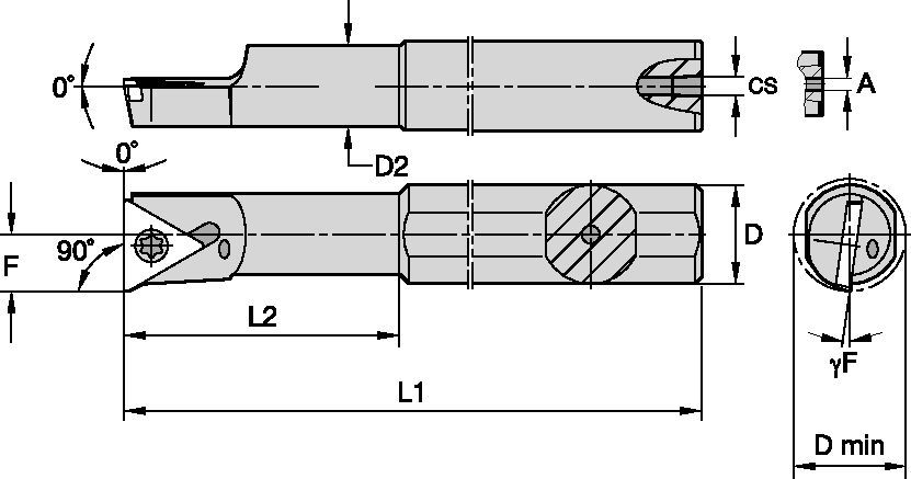

Drawings for 1094651
Material Number1094651
ISO Catalog IDA0506STFPR18
ANSI Catalog IDA0506STFPR18
[D] Adapter / Shank / Bore Diameter9.525 mm
[D] Adapter / Shank / Bore Diameter0.375 in
[DM] Minimum Bore Diameter 10.541 mm
[DM] Minimum Bore Diameter 0.415 in
[F] F Dimension 5.436 mm
[F] F Dimension 0.214 in
[L1] Tool Length 127 mm
[L1] Tool Length 5 in
[L2] Head Length 41.276 mm
[L2] Head Length 1.625 in
[A] Coolant Hole Diameter 3.175 mm
[A] Coolant Hole Dia 0.125 in
Gage InsertTP..18151
Insert Screw ID Drive SizeT7
