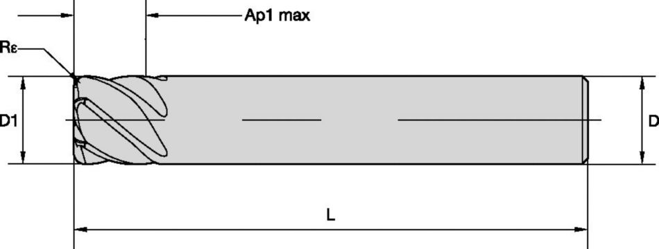

Drawings for 5352359
Material Number5352359
ISO Catalog IDEADE0188J6ARX
ANSI Catalog IDEADE0188J6ARX
GradeKYS40
[Re] Corner Radius 0.6 mm
[Re] Corner Radius 0.024 in
[Z] Number of Flutes6
[D1] Effective Cutting Diameter4.763 mm
[D1] Effective Cutting Diameter0.1875 in
[D] Adapter / Shank / Bore Diameter4.763 mm
[D] Adapter / Shank / Bore Diameter0.1875 in
[AP1MAX] 1st Maximum Cutting Depth3.572 mm
[AP1MAX] 1st Maximum Cutting Depth0.1406 in
[L] Overall Length 50.8 mm
[L] Overall Length 2 in
