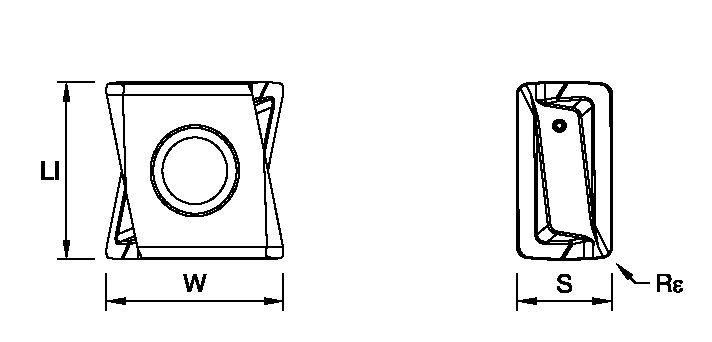

Drawings for 6969920
Material Number6969920
ISO Catalog IDLNGQ120616ERGEKT4
ANSI Catalog IDLNGQ120616ERGEKT4
GradeKCK20B
[LI] Insert Length 13 mm
[LI] Insert Length 0.5118 in
[S] Insert Thickness6.35 mm
[S] Insert Thickness0.25 in
[W] Insert Width 13.141 mm
[W] Insert Width 0.5174 in
[Rε] Corner Radius 1.55 mm
[Rε] Corner Radius 0.061 in
Cutting Edges per Insert4
