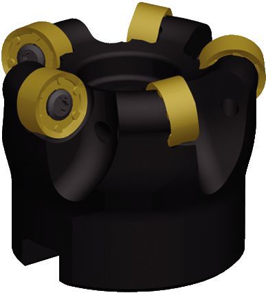

Rodeka™ IC 16 • KDR RN1605 CT • Shell Mills • Metric
Material Number5153837
ISO Catalog IDKDR50Z04S22RN16ANSI Catalog IDKDR50Z04S22RN16
Rodeka™ IC 16 - KDR RN1605 CT - Shell Mills - Metric 5153837 - Kennametal
$871.19/each
  • 3D Profiling3D Profiling
  • PocketingPocketing
Drawings for 5153837
[D1MAX] Maximum Cutting Diameter50 mm
[D1MAX] Maximum Cutting Diameter1.969 in
[D1] Effective Cutting Diameter34 mm
[D1] Effective Cutting Diameter1.339 in
[D] Adapter / Shank / Bore Diameter22 mm
[D] Adapter / Shank / Bore Diameter0.866 in
[D6] Hub Diameter 42 mm
[D6] Hub Diameter 1.654 in
[L] Overall Length 50 mm
[L] Overall Length 1.969 in
[AP1MAX] 1st Maximum Cutting Depth3.96 mm
[AP1MAX] 1st Maximum Cutting Depth0.156 in
Number of Inserts4
Maximum Ramping Angle0.49
Weight Kilograms0.36
Max RPM26700
Gage InsertRNGJ1605M0____
  • Double-sided round inserts with 12 indexable positions.
  • Anti-rotation features enable higher cutting data and extra stability.
  • Pocketing and profiling capabilities.
