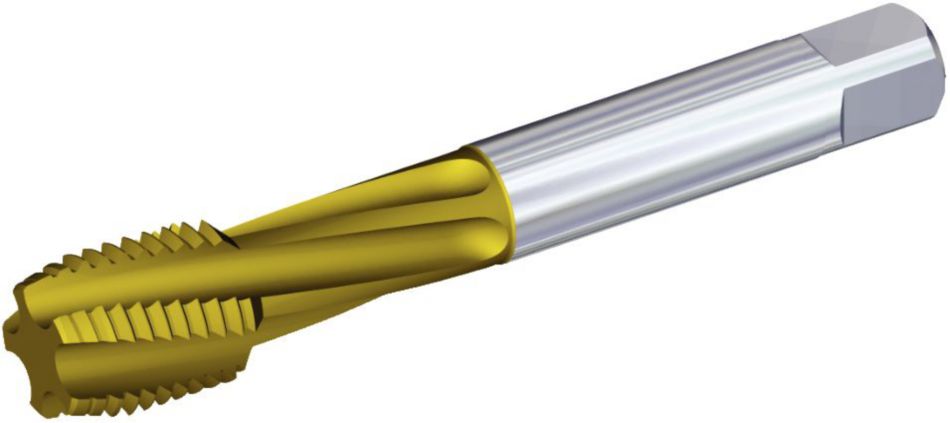

T650 • Metric DIN 376 • Form C Semi-Bottoming Chamfer • Wind Energy
Beyond™ Spiral-Flute HSS-E-PM Taps • Blind Holes
Material Number4153874
ISO Catalog IDT650M240X300R6HX-D6ANSI Catalog IDT650M240X300R6HX-D6

  • Threading: Blind HoleThreading: Blind Hole
  • Class of Fit: 6HXClass of Fit: 6HX
  • DIN number 376DIN number 376
  • Chamfer Form C (2–3)Chamfer Form C (2–3)
  • HSS-E-PMHSS-E-PM
  • Tapping Helix Angle: 15°Tapping Helix Angle: 15°
GradeKP6525
[D1-TDZ] Thread Diameter SizeM24 X 3
[L] Overall Length 160 mm
[L] Overall Length 6.3 in
[L3] Thread Length 30 mm
[L3] Thread Length 1.18 in
[L2] Useable Length 77 mm
[L2] Useable Length 3.03 in
[D] Adapter / Shank / Bore Diameter18 mm
[D] Adapter / Shank / Bore Diameter0.7087 in
[Z] Number of Flutes4
Dimension StandardDIN 376
Thread Tolerance Class ISO6HX-I

Coated HSS-E-PM. PVD — heat- and wear-resistant high vanadium — cobalt powder metal HSS substrate coated with wear-resistant TiCN base layer and low-friction TiN top layer. Use in steel, cast iron, and cast aluminum with silicon.
  • KP6525 TiCN + TiN for tapping steel and cast iron.
