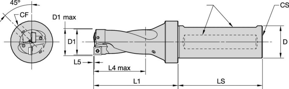

Drawings for 5689607
Material Number5689607
ISO Catalog IDDFSP0703R2SSF075
ANSI Catalog IDDFSP0703R2SSF075
[D] Adapter / Shank / Bore Diameter19.05 mm
[D] Adapter / Shank / Bore Diameter0.75 in
[D1] Drill Diameter M 17.856 mm
[D1] Drill Diameter M 0.7031 in
[D1MAX] Drill Diameter Maximum18.857 mm
[D1MAX] Drill Diameter Maximum0.7424 in
[L1] Insert Gage Length 59.5 mm
[L1] Insert Gage Length 2.3425 in
[L4] Maximum Drilling Depth 35.712 mm
[L4] Maximum Drilling Depth 1.406 in
[L5] Drill Point Length0.51 mm
[L5] Drill Point Length0.0201 in
[LS] Shank Length 50.8 mm
[LS] Shank Length 2 in
[CF] Coolant Size Radial1/8 - 27 NPT
[CS] Coolant Supply Size1/8 - 27 NPT
Gage InsertSPGX0603.
Gage Insert 2DFT0303.
