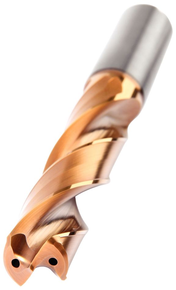

[D1] Drill Diameter M 16.67 mm
[D1] Drill Diameter M 0.6563 in
[L] Overall Length 143 mm
[L] Overall Length 5.6299 in
[L3] Flute Length 92 mm
[L3] Flute Length 3.622 in
[L4] Maximum Drilling Depth 73 mm
[L4] Maximum Drilling Depth 2.874 in
[L5] Drill Point Length4.17 mm
[L5] Drill Point Length0.1642 in
[LS] Shank Length 48.5 mm
[LS] Shank Length 1.9094 in
[D] Adapter / Shank / Bore Diameter17.4625 mm
[D] Adapter / Shank / Bore Diameter0.6875 in
  • DrillingDrilling
KCK10A
KCK10A
Composition: Multilayered PVD AlTiN-based coated submicron grain carbide with superior surface finish.
Application: First choice for cast iron. This grade utilizes a newly developed coating combined with a state-of-the-art surface condition to offer extraordinary wear resistance in abrasive materials at elevated cutting conditions with improved performance consistency.
  • HPR point thinning provides excellent self-centering capabilities along with low-thrust, enabling maximum hole straightness.
  • 4 margin lands are deal for cross holes and inclined exits, proving maximum stability.
  • Drills holes 5X its diameter, making it ideal for deep-hole applications.
  • AlTiN/AlTiSiN multi-layer coating withstands abrasive and thermal loads to increase tool life.
  • Patented corner radius enables long tool life and excellent hole quality by avoiding workpiece chipping during evacuation.
  • HA shank design reduces vibration and provides increased stability, reducing the risk of breakage. All shanks are Minimum Quantity Lubrication (MQL) ready and fulfill the DIN 6535 and 69090-03 requirements.
