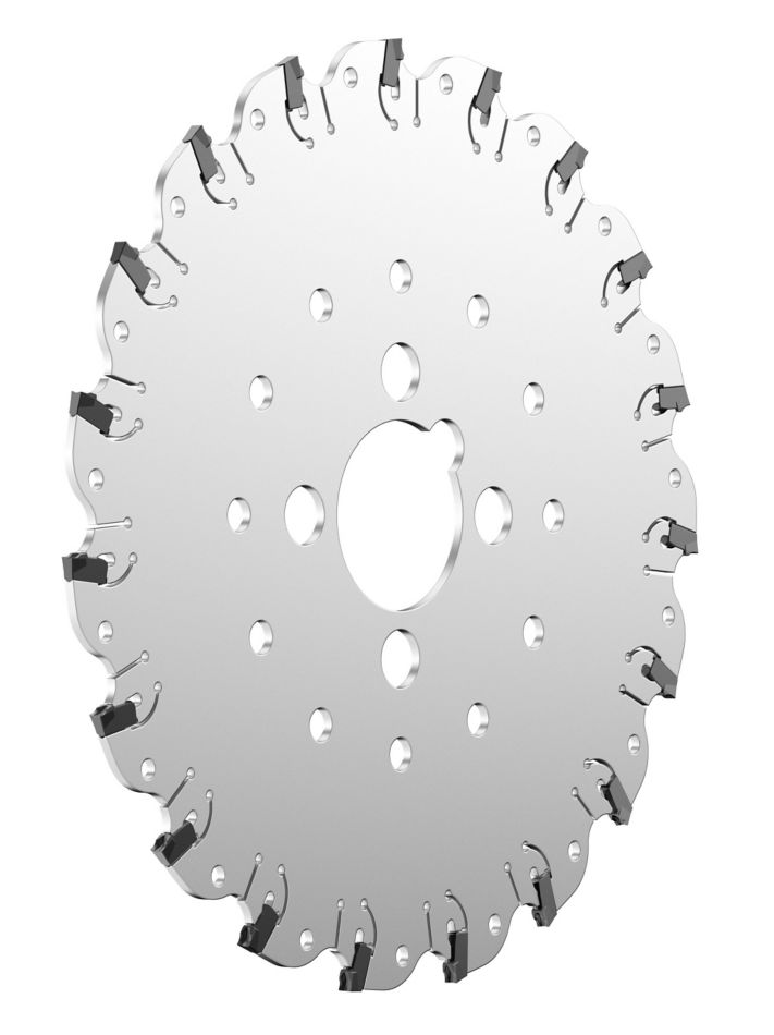

KVNS™ A2™ • Arbor Mount • Metric
Slot milling cutter for multiple materials
Material Number1246118
ISO Catalog ID4.97060130ANSI Catalog ID4.97060130
- P Steel
- M Stainless Steel
- K Cast Iron
- N Non-Ferrous
- S High-Temp Alloys
- .caption
Slotting: Side with AE/AP dimensions
- Overview
- Application Data
- Downloads
- Spare Parts
- Reviews
- Q&A
| Material Number | 1246118 |
| ISO Catalog ID | 4.97060130 |
| ANSI Catalog ID | 4.97060130 |
| [BM] Cutting Width Minimum | 3 mm |
| [BM] Cutting Width Minimum | 0.1181 in |
| [D1] Effective Cutting Diameter | 63 mm |
| [D1] Effective Cutting Diameter | 2.48 in |
| [CDX] Radial Maximum Depth of Cut | 15 mm |
| [CDX] Radial Maximum Depth of Cut | 0.5906 in |
| [D] Adapter / Shank / Bore Diameter | 16 mm |
| [D] Adapter / Shank / Bore Diameter | 0.6299 in |
| [THUB] Hub Thickness | 2.4 mm |
| [THUB] Hub Thickness | 0.0945 in |
| Number of Inserts | 4 |
| Weight Kilograms | 0.04 |
| Gage Insert | 3.90030____ |
| Max RPM | 5100 |
- Steel
- Stainless Steel
- Cast Iron
- Non-Ferrous
- High-Temp Alloys
- .caption
- Self-clamping insert seat with fixed stop.
- Excellent for all flat-bottom slotting and cut-off operations.
- Two drive rings required for each cutter body. They must be ordered separately, and in pairs of two.
- For cutter diameters 200mm and 250mm support rings are optional (instead of drive rings). Support rings also must be ordered separately, and in pairs of two.
