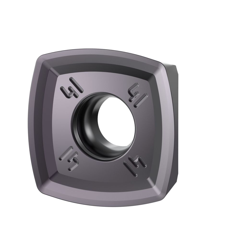

7792VXE16 Series • Carbide Insert • XELT-D41 • Medium Machining
High-feed copy milling insert with four cutting edges, precision ground.
物料号5653140
公制样本编号XELT160512ERD41英制样本编号XELT160512ERD41
XELT16-D41 - Best fit for face milling and slotting operation. General purpose in soft steels 5653140 - Kennametal

Drawings for 5653140
物料号5653140
材质SP6519
[SSC] 刀片 IC 尺寸16.8 mm
[SSC] 刀片 IC 尺寸0.661 in
[LI] 刀片长度 16.789 mm
[LI] 刀片长度 0.661 in
[S] 刀片厚度5.563 mm
[S] 刀片厚度0.219 in
[Rε] 刀尖半径 1.2 mm
[Rε] 刀尖半径 0.047 in
平均切屑厚度 [HM]0.05 mm
平均切屑厚度 [HM]0.002 in
[RT] 理论刀尖半径编程4.18 mm
[RT] 理论刀尖半径编程0.165 in
工件材料
  • 不锈钢
  • 高温合金
SP6519
SP6519
PVD TiAlN 纳米涂层硬质合金材质,韧性基体材料。主要用于干式和湿式的一般加工和重型加工应用。
  • Pressed-to-size, for lowest cost per cutting edge.
  • Single-sided copy milling insert for machining of steels, stainless steel, and high-temperature alloys.
