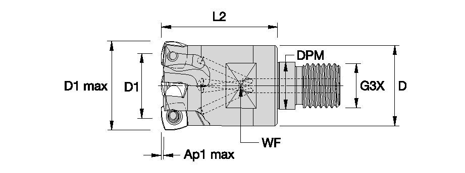

7792VXP06 Series • End Mill • Screw-On • Inch
High-Feed copy milling cutter for multiple materials.
Material Number109321447
- Internal coolant supply.
- Positive design to support low cutting forces and applications with long overhang.
Spiral Circular
