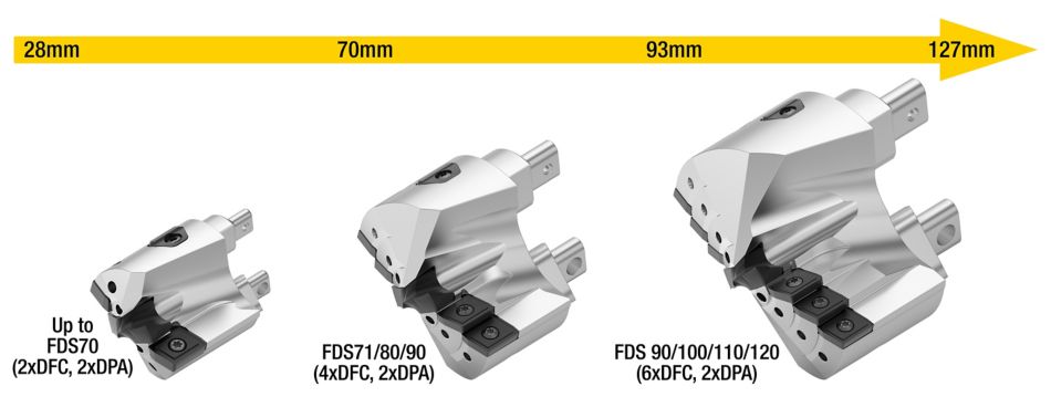

KSEM PLUS™ Modular Drill for Large Diameter Drilling
The KSEM PLUS modular drill covers drilling applications in a diameter range from 28mm to 101,6mm (1.102-4”) up to 10 x D. KSEM PLUS combines the advantages of a modular drill and an indexable drill, providing high speed and feed capability with large length-to-diameter ratio at low consumable cost. This modular system is a versatile solution that allows quick tool set-up and helps to keep tool inventory at a minimum.
Interchangeable head styles with two fully effective cutting edges deliver excellent productivity in all cutting conditions and many materials:
  • The KSEM PLUS A1 head for lowest cost per hole.
  • The KSEM PLUS B1 head for challenging conditions like stacked plates, cross holes, and inclined exits.
  • Interchangeable head styles with two fully effective cutting edges deliver excellent productivity in all cutting conditions and many materials.
  • Two fully effective cutting edges deliver excellent productivity.
NEW! KCMS40 for KSEM PLUS MD Inserts
Made with advanced HiPIMS coating technology, this grade is perfect for machining stainless steel, high-temp alloys and long-chipping steel.
  • Maximum process reliability with longest tool life on stainless materials
  • Smooth coating surface prevents build up on cutting edges for consistent machining process
  • Grade combines optimum coating adhesion and high carbide toughness
  • MD geometry provides superior chip control and surface finish
