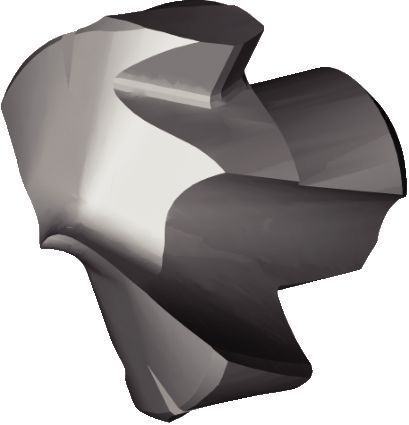

Composition: Multilayered PVD AlCrN-based coated fine-grain carbide.
Application: First choice for cast iron. Due to the uniquely developed coating, this grade exhibits extraordinary wear resistance in abrasive materials offering the highest material removal rates.
  • KenTIP KC7410™ HPCCL focuses on tool life and process reliability in all cast iron materials. It offers increased feed forces and increases your productivity.
  • HPCCL geometry offers a wide and strong HP-style chiseled edge that prevents material quenching in the center, enabling high feed rates. With a corner chamfer and strong edges, it creates high quality holes with increased tool life.
  • KC7410 is a multilayer AlCr-based coating over fine grain carbide. It is extraordinarily wear resistant in cast iron applications due to its high hot hardness.
  • Use KC7410 HPCCL in all cast iron applications, especially when working in difficult conditions and CGI or ADI irons.
