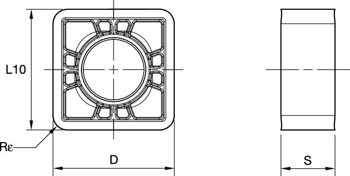

Drawings for 5630742
Material Number5630742
ISO Catalog IDSNPJ10T308SNGD
ANSI Catalog IDSNPJ31252SNGD
GradeKCK15
[D] Insert IC Size10 mm
[D] Insert IC Size0.394 in
[S] Insert Thickness3.98 mm
[S] Insert Thickness0.157 in
[L10] Insert Cutting Edge Length10 mm
[L10] Insert Cutting Edge Length0.394 in
[Rε] Corner Radius 0.8 mm
[Rε] Corner Radius 0.031 in
Average Chip Thickness [HM]0.078 mm
Average Chip Thickness [HM]0.0031 in
Cutting Edges per Insert8
