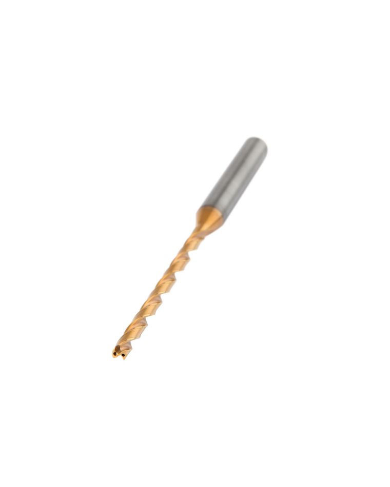

KenDrill™ Deep HPR • 12 x D • Internal Coolant • Straight Shank • Metric
Solid Carbide Deep Hole Drill for Cast Iron and Steels

GradeKCK10A
[D1] Drill Diameter M 3 mm
[D1] Drill Diameter M 0.1181 in
[L] Overall Length 93 mm
[L] Overall Length 3.6614 in
[L3] Flute Length 52 mm
[L3] Flute Length 2.0472 in
[L4] Maximum Drilling Depth 44 mm
[L4] Maximum Drilling Depth 1.7323 in
[L5] Drill Point Length0.56 mm
[L5] Drill Point Length0.022 in
[LS] Shank Length 36 mm
[LS] Shank Length 1.4173 in
[D] Adapter / Shank / Bore Diameter6 mm
[D] Adapter / Shank / Bore Diameter0.2362 in

Composition: Multilayered PVD AlTiN-based coated submicron grain carbide with superior surface finish.
Application: First choice for cast iron. This grade utilizes a newly developed coating combined with a state-of-the-art surface condition to offer extraordinary wear resistance in abrasive materials at elevated cutting conditions with improved performance consistency.
Vlastnosti a výhody
  • Proven performance with our HPR drills geometry, featuring our heat and wear resistant KCK10A grade.
  • High productivity with speed four times faster than conventional drills.
  • Longer tool life in steel and iron compared to competitors.
  • Highly polished surfaces for friction reduction and superior chip evacuation with low-pressure coolant.
