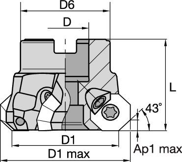

[D1] Effective Cutting Diameter101.6 mm
[D1] Effective Cutting Diameter4 in
[D1MAX] Maximum Cutting Diameter110.236 mm
[D1MAX] Maximum Cutting Diameter4.34 in
[D] Adapter / Shank / Bore Diameter31.75 mm
[D] Adapter / Shank / Bore Diameter1.25 in
[D6] Hub Diameter 73.15 mm
[D6] Hub Diameter 2.88 in
[L] Overall Length 44.45 mm
[L] Overall Length 1.75 in
[AP1MAX] 1st Maximum Cutting Depth3.5 mm
[AP1MAX] 1st Maximum Cutting Depth0.138 in
Number of Inserts10
Weight Pounds3.23
Max RPM6270
