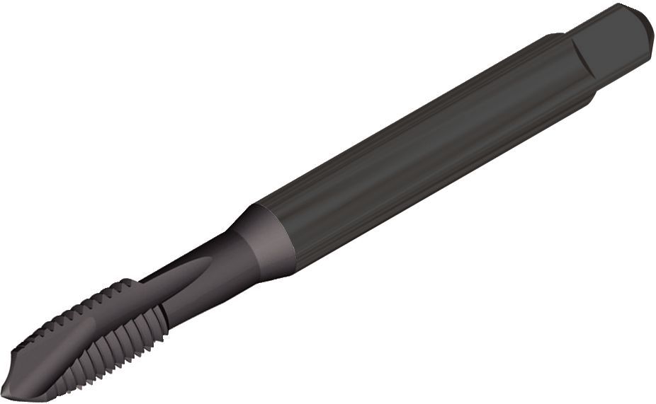

T820 • Form B Plug Chamfer • Machine Screw and Fractional • DIN 371 and 376
GOtap™ T820 Spiral-Point HSS-E Taps • Through Holes
Material Number5479691
ISO Catalog IDT820NC06-32R2B-D1ANSI Catalog IDT820NC06-32R2B-D1
- P Steel
- M Stainless Steel
- K Cast Iron
Multipurpose Taps: Spiral Point
Tapping: Through Hole
Class of Fit: 2B
DIN number 371
DIN number 376
38618
Chamfer Form: Plug Chamfer (3–5)
Flood Coolant: Tapping
Manufacturer’s Specs: UNF
Manufacturer’s Specs: UNC
| Material Number | 5479691 |
| ISO Catalog ID | T820NC06-32R2B-D1 |
| ANSI Catalog ID | T820NC06-32R2B-D1 |
| Grade | KSP39 |
| [D1-TDZ] Thread Diameter Size | #6 - 32 |
| [L] Overall Length | 56 mm |
| [L] Overall Length | 2.2 in |
| [L3] Thread Length | 9 mm |
| [L3] Thread Length | 0.35 in |
| [L2] Useable Length | 20 mm |
| [L2] Useable Length | 0.79 in |
| [D] Adapter / Shank / Bore Diameter | 4 mm |
| [D] Adapter / Shank / Bore Diameter | 0.1575 in |
| [Z] Number of Flutes | 2 |
| Dimension Standard | DIN 371 |
| Thread Tolerance Class ANSI | 2B |
