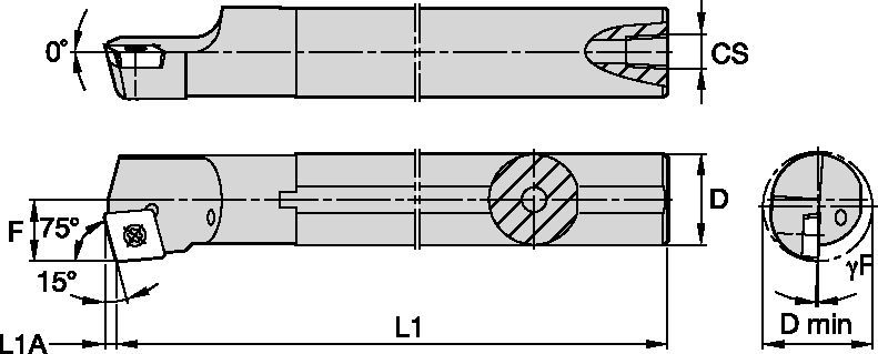

  • I.D. TurningI.D. Turning
Drawings for 1098236
Material Number1098236
ISO Catalog IDA20SSCKPR09
ANSI Catalog IDA20SSCKPR09
[D] Adapter / Shank / Bore Diameter20 mm
[D] Adapter / Shank / Bore Diameter0.79 in
[DM] Minimum Bore Diameter 25 mm
[DM] Minimum Bore Diameter 0.984 in
[F] F Dimension 13 mm
[F] F Dimension 0.512 in
[L1] Tool Length 250 mm
[L1] Tool Length 9.843 in
[LH] Head Length 29 mm
[LH] Head Length 1.142 in
[L1A] L1 A Dimension 2.27 mm
[L1A] L1 A Dimension 0.089 in
[A] Coolant Hole Diameter 4 mm
[A] Coolant Hole Dia 0.157 in
[CS] Coolant Supply Size1/8-27 NPT
Gage InsertCP..09T308
Insert Screw ID Drive SizeT15
