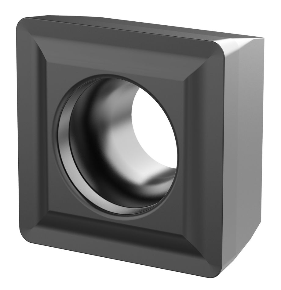

Material Number6573320
ISO Catalog IDSPGX060304LP
ANSI Catalog IDSPGX060304LP
GradeKCU25
[D] Insert IC Size6.35 mm
[D] Insert IC Size0.25 in
[D1] Insert Hole Size 2.65 mm
[D1] Insert Hole Size 0.104 in
[S] Insert Thickness3.18 mm
[S] Insert Thickness0.125 in
[Rε] Corner Radius 0.4 mm
[Rε] Corner Radius 0.016 in
[GAA] Insert Rake Angle3.5
[Clearance Angle Major7
Clearance Angle Major Second11
KCU25
KCU25
Composition: An advanced PVD grade with hard AlTiN coating and fine-grain unalloyed substrate. The new and improved coating improves edge stability with wide range speed and feed capabilities.
Application: The KCU25™ grade is ideal for general machining of most steels, stainless steels, high-temp alloys, titanium, irons, and non-ferrous materials in a wide range of speeds and feeds with improved edge toughness for interrupted cuts and high feed rates.
  • LP geometry for improved control of chip flow, chip breakage and chip curling
  • Inserts support drilling in P0 and P1 steel, higher alloyed tool steels and stainless steels where high feed rates cannot be used to provide short chips
