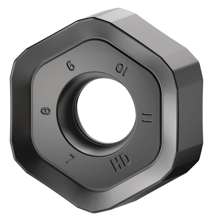

Face milling insert with twelve cutting edges
Material Number4057639
ISO Catalog IDHNPJ1307ANSNHDANSI Catalog IDHNPJ75ANSNHD
GradeKCPK30
[D] Insert IC Size22.225 mm
[D] Insert IC Size0.875 in
[BS] Corner Facet Length 1.88 mm
[BS] Corner Facet Length 0.074 in
[L10] Insert Cutting Edge Length12.832 mm
[L10] Insert Cutting Edge Length0.5052 in
[Rε] Corner Radius 1.2 mm
[Rε] Corner Radius 0.047 in
[S] Insert Thickness7.34 mm
[S] Insert Thickness0.289 in
Average Chip Thickness [HM]0.254 mm
Average Chip Thickness [HM]0.01 in
Cutting Edges per Insert12
KCPK30
KCPK30
Coated carbide grade with CVD multilayer (TiN/TiCN/Al2O3) and advanced Beyond™ post-coat treatment. Substrate is very tough. KCPK30 has a wide application area in general and roughing milling of steels and cast irons. Performs best dry, but can also be used wet.
