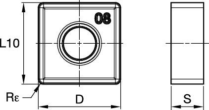

Drawings for 6784216
Material Number6784216
ISO Catalog IDSNHJ100408ENLEH
ANSI Catalog IDSNHJ332ENLEH
GradeKCSM40
[D] Insert IC Size10 mm
[D] Insert IC Size0.394 in
[S] Insert Thickness4.52 mm
[S] Insert Thickness0.178 in
[L10] Insert Cutting Edge Length10 mm
[L10] Insert Cutting Edge Length0.394 in
[Rε] Corner Radius 0.8 mm
[Rε] Corner Radius 0.031 in
Average Chip Thickness [HM]0.04 mm
Average Chip Thickness [HM]0.0016 in
Cutting Edges per Insert8
KCSM40
KCSM40
  • Inserts with corner radii 0.8mm (.031") fit with every pocket.
