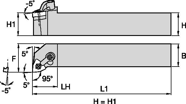

[H] Shank Height 25 mm
[H] Shank Height 0.984 in
[B] Shank Width 25 mm
[B] Shank Width 0.984 in
[F] F Dimension 32 mm
[F] F Dimension 1.26 in
[L1] Tool Length 150 mm
[L1] Tool Length 5.906 in
[LH] Head Length 25 mm
[LH] Head Length 0.98 in
Gage InsertWN..060408
Lock Pin ID Drive Size2 mm
Clamp Screw ID Drive Size2.5 mm
